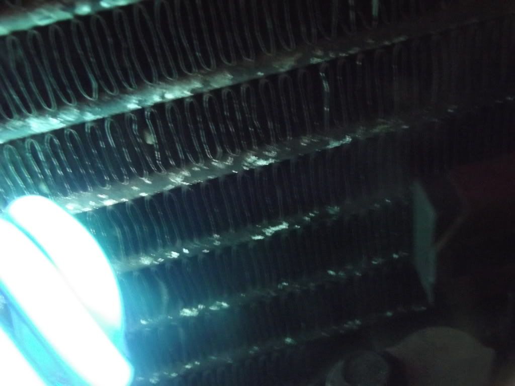

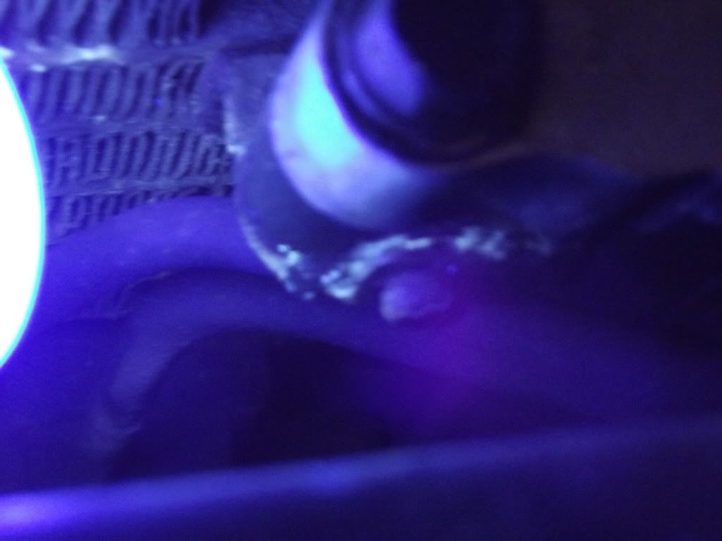

Heres what I see:

does it look like that o ring was leaking
1991 Honda Accord 173,000 Miles
It can be hard to tell months after the leak because the dye washes away and/or gets covered over. If the pressure is zero now, go ahead and take apart the connection, check for corrosion and fit a new o-ring. Like HECAT said, the o-rings on both ends of the line from the compressor to the condenser are prone to harden and leak because that line runs hotter than any other part of the system.
